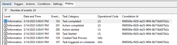

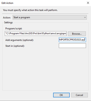

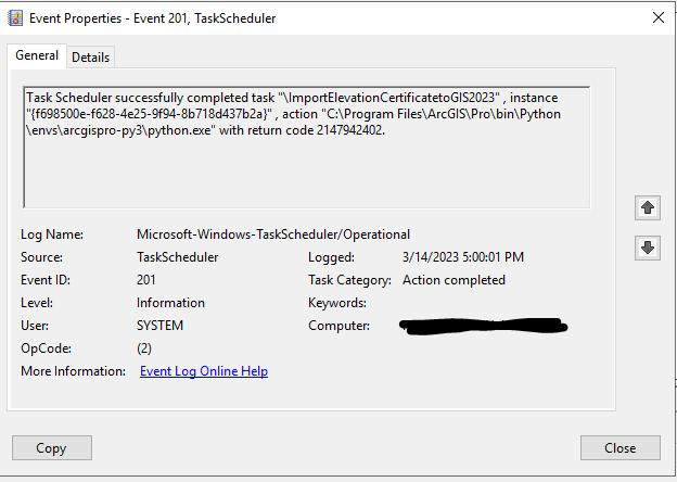

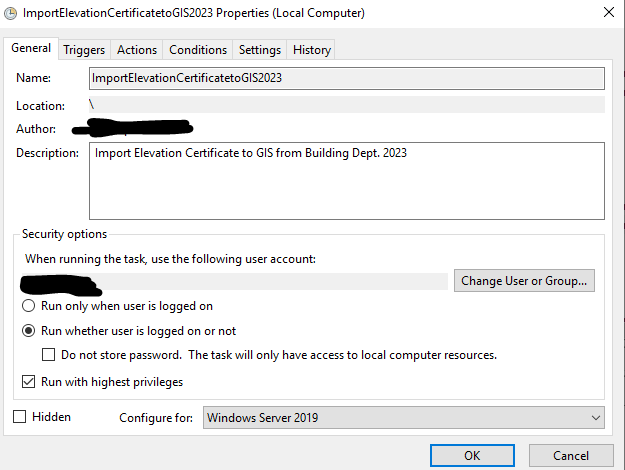

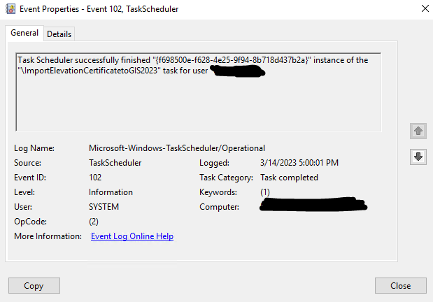

Hello all,
I have ArcGIS Pro 3.0, window task scheduler and python 27. I am not expertise with window task scheduler. Please see screenshots and error below. It is working successful when I run python script manually. But when I tried to run window task scheduler, I got error messages. I am not sure what to do. Please kindly assist. Thank you so much in advance.
ERROR MESSAGES
AlexP__1-1678912026620.pngAlexP__1-1678912026620.pngAlexP__1-1678912944089.pngAlexP__1-1678912944089.png

I see you have it set to run whether user logged in or not, so possibly running scheduled task when not logged in.
Not sure if this is your issue, but may be related to this line:
docFolder = r"Q:\2023\IMPORTED TO GIS"
Only the local drives (C:\) exist when no user is logged in.  The mapped drives are user specific, so when nobody is logged in, the Q: drive doesn't exist.
Try using the UNC paths for everything other than local drives and see if it helps.

Hi Alex,
I never used WinTS myself but just got curious and checked your screenshots and did not see any explicit error message, except for the one that returned code 2147942402. So, I looked that up and apparently it has something to do with the path of the executable that you pass. Based on what I read you need to make sure all the paths really exist and there is no typo there. In "C:\Program Files\ArcGIS\Pro\bin\Python\envs\... " or the part 'add arguments (optional)' that you wrote your script's name. Make sure to enter the full path to your script there.
Check this link. Not the exact problem but might worth checking. Sorry that's all I've got for now. Hopefully you will find an answer soon.
AlexP_
Hello,
Thank you for your reply. the add argument is already add full path. by full path, I have different letter than C: and it is already set up map network. I am gonna try using UNC as per @RhettZufelt .

Hello @RhettZufelt Thank you for your reply. Do I also need to input UNC path on add argument optional since it is not letter C:?
RhettZufelt
MVP Notable Contributor
"ANY" paths that are not on the local drive will need to be UNC for it to run as scheduled task when user not logged in.
