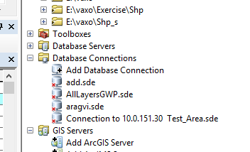

Hi guys,
I want to get list of my database connections (see pic.)  in Arcpy to display them in my tool dropdown list, i try next code:
workspaces = arcpy.ListWorkspaces("*", "SDE")
    for workspace in workspaces:
        print workspace
but it does not give any result.  How can i do that?
Thank you

1) Question: what did the print statement produce?
Answer: Print statement should produce list of database connections i have in TOC. (See pic. please)
2) Question: where in your code did you set your workspace to start the search?
Answer: I set workspace at the beginning of my code, after Import arcpy and import os.
I might on wrong way and try to achieve wrong result, but i thought this is a right way :(.

Hello, for me all me SDE connections are in the same folder (workspace) so if you define the workspace, you should get your listing of SDE databases. Worked for me. 🙂 (in Catalog, right click the SDE connection, select properties and look at the path of the "name")
import arcpy
arcpy.env.workspace = r"C:\Users\USERNAME\AppData\Roaming\ESRI\Desktop10.8\ArcCatalog"
# List all file geodatabases in the current workspace
    print workspace
