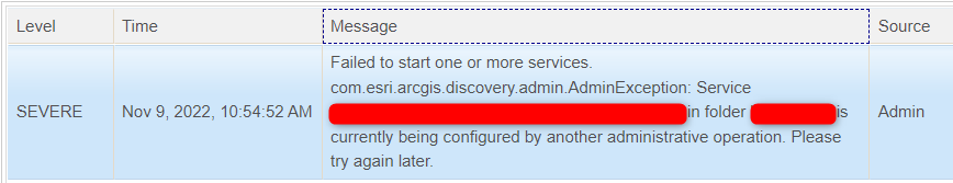

If I check status of the Service object, I can see that the start command is accepted but not executed accepted
7. On the Logs page I see following message, although there is nobody else working on the server except me
8. In order to get service back consistent state, I have to click stop button manually on the services page of the ArcGIS Server Manager
