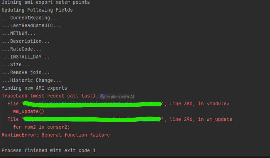

I have a script designed to update water meter usage and plot new meters.
The script runs fine and updates the water meter usage, but it fails when it reaches the block of code that involves a cursor to look for new meters.
After days of attempting to solve this myself with the assistance of ChatGPT. I figured I would, at the risk of looking like a fool, reach out here.

Unfortunately, without the actual code, we're not going to be able to help you. Could you post your code block here, too?

AdamTerrell
I believe this is the area the code is failing in

TonyAlmeida
MVP Regular Contributor
Does feature_class2 have null values, locked records, or invalid geometries, this can cause a cursor failure.
see what prints on
with arcpy.da.SearchCursor(feature_class2, [field_to_compare_2]) as Cursor2:
    for row2 in Cursor2:
        print(row2)  # Check the output
JoshuaBixby
MVP Esteemed Contributor
I can't say it is the cause of your issue, but don't mix the field name wild card while also explicitly naming fields because it results in duplicate columns in the cursor.

AlfredBaldenweck
MVP Frequent Contributor
Re @TonyAlmeida's suggestion:
To keep it simple for yourself, just insert his code onto line 275 on the original block you posted (immediately before where you make cursor2.
            # Create a search cursor for the first feature class
            print("finding new AMI exports")
            # Create a search cursor for feature_class1 to populate unique_values set
            with arcpy.da.SearchCursor(feature_class1, [field_to_compare_1]) as cursor1:
                for row1 in cursor1:
                    value = row1[0]
                    unique_values.add(value)
            #Add this break in here to stop the loop.
            # Right now it's looping through a list of csvs so we're just
            # breaking the loop before it goes farther than this cursor.
            # If there isn't any error, then it'll pop you what is currently
            # line 362.
            break
            # Create a search cursor for feature_class2 to compare with unique_values
            with arcpy.da.SearchCursor(feature_class2, ['OID@', field_to_compare_2, 'SHAPE@', '*']) as cursor2:
                for row2 in cursor2:
                    value2 = row2[1]
                    if value2 not in unique_values:
                        differences.append(row2)
Re @JoshuaBixby's suggestion mixing the wildcard and the fieldnames:
                    value2 = row2[1]
Let's assume your feature class has 6 fields: OID, Field1, Field2, Field3, ShapeLeng, ShapeArea.
In this scenario, we're assigning Field2 to field_to_compare_2,  and then for our cursor, telling the computer to give us X fields from the table, then going through the table row by row to get the information we want.
Ok, cool. Here's the wrinkle.
Sometimes, you don't want to call out specific fields and it doesn't super matter for what you're doing. So what you do instead is throw in a wildcard ('*') into your field list. Great, now I can just get the entire row with every field in the table.
What you're doing right now is asking the computer return the fields you named, PLUS all the other fields.
So it's returning the following list: [OID@, Field2, SHAPE@, OID, Field1, Field2, Field3, ShapeLeng, ShapeArea]
*Sidenote: the OID@ returns the unique ID column for the table, which is typically one of the following: ObjectID, OID, FID. In my example, OID@ is returning the field named 'OID'.
What Josh is suggesting is that this may be causing some of your problems, e.g. returning your Unique ID field and Field2 twice each.
Testing on my own data, it didn't throw any errors for me, but it's a good practice to clean it up anyway.
Hopefully this kind of helps?
Also, I know you say you have permissions, but

AdamTerrell
I am going to attempt to rerun this, I have made the suggested changes, but want to verify I am inserting the code into the correct location. I have a long header in my script so our line numbers are not the same.

AlfredBaldenweck
Mostly right.
Unindent the break once so that it lines up with the "with arcpy.da.SearchCursor", or else it's going to stop after the first row in the cursor. For this testing, we want to see all the rows in the cursor, and break the loop of CSVs afterwards.
And yeah, get rid of the '*' once you see what errors, if any, there are when you run the community-suggested code.
Also, to @TonyAlmeida 's point, have you tried using a Repair Geometry on your tables before running the cursors?
