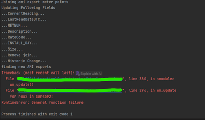

I AM NOT A DEVELOPER. Zero Python experience.
I have taken over a role where my predecessor automated nearly everything with Python scripts. To this point, I have been able to maintain and/or fix various scripts using ChatGPT.
I have a script designed to update water meter usage and plot new meters.
The script runs fine and updates the water meter usage, but it fails when it reaches the block of code that involves a cursor to look for new meters.
After days of attempting to solve this myself with the assistance of ChatGPT. I figured I would, at the risk of looking like a fool, reach out here.

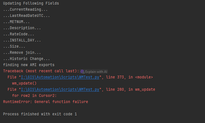

Latest run with the added code. Not sure what the new code is doing. Nothing prints.
AlfredBaldenweck
MVP Frequent Contributor
Basically it's failing in the cursor.
Just for funsies, replace the "field_to_compare2" in what we added with another field like "OBJECTID" (assuming you have OBJECTID in that table).
Then, after that fails (probably will), try adding Repair Geometry on featureclass2 immediately before the cursor and see if that fixes anything.
AdamTerrell
I did look at the repair geometry documentation you provided. These are just point features and some null values are ignored when converting the table to points. I do not belive ObjectID is in the csv, but it is probably in one of the joined tables, which I thought is what the cursor is looking through.
