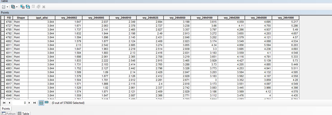

In the table on the Image below, ippt_allsi represents precipitation amounts for a given storm.  The rest of the fields represent the precipitation amounts for that number of years recurrence intervals.  2, 5,10, 25, 50 and so on.  I need a script that will take the precipitation amount for the storm, (appt_allsi) then find the bounding larger and smaller values and interpolate the recurrence year by where the precipitation amount falls between those years values.  For instance, for the first record, 3.84 inches of rain fell.  The 100 year amount is 3.615 and the 200 year amount is 4.059.  How would I return the interpolated recurrence year for the 3.84 inches?  I am fairly new to python and am struggling.  Could somebody please get me started in the right direction?
DanPatterson_Retired
MVP Emeritus
Verbose demo with constructed featureclass... only 5 records,  number isn't relevent, can create output directly.

12 Replies
MVP Emeritus
The whole process can be vectorized using numpy.  A simple example using a 1D interpolation for the years spanning the data value are show in the following.  You can get your table out to a numpy array using TableToNumPyArray or FeatureClassToNumPy array and do you processing in python.
Perhaps this is for a later stage in you python progress, but keep it in mind for the future (ps... the decimal points are useless and should have been enclosed in int(val)

Thank you so much!  I am still a little confused on how to find the bounding precipitation values and years and assign them to the variables for all of the 500K points.
MVP Emeritus
As I said, this may be for the future, but here is an example

Thanks for taking the time yesterday to show me about numpy and arrays.  I have created an array of my point feature class.  Can you please provide an example syntax of how I would loop through the array and assign the variables to obs and v to do the calculation for rec_int?  When I use arr.shape on my array it says I have 378288 records but no rows.  Is this ok or will I need to reshape it somehow?  I tried a bit but didn't have much luck.  I assume then this array can be converted back to points once the Recurrence interval field is calculated?    Any help would be greatly appreciated.  Thanks and have a great day.
MVP Emeritus
Since you have field names, then you have a structured array, the array will be in the form:

I get your example when you manually put in the V values.  However, the V value and the obs value will need to be dynamic variables.  Here is a breakdown of exactly what I am trying to do.  If you look at the above Image, its the attribute field of my point feature class.  The Precip_Amount is the observed depth.  "obs" variable.  The next 8 fields are precipitation Frequency depth amounts by year.  Each field representing a year amount. 5, 10, 25 and so on.  "v" variable.  I want to use those and the harcoded "Years" variable to interpolate the ARI field with the recurrence interval.  This will have to be done for 370k records with different v and obs values for every record.  Then I want to export the points to a raster.  Which I know how to do but if I go to an array I need to be able to get back to points.
MVP Emeritus
row 1, precip 1.18, your field names are the 5,10,25,50,100,200,500,1000 year (aka...Time)
obs
            5, 10, 25, 50,100, 200, 500, 1000                                  Time
1.18   1.977, 2.242, 2.539, 3.001, 3.393, 3.814, 4.424,4.932   Val_1
    etc etc    val 2 val 3
just export precip amount and over to the left for a dozen or so records into a text file or csv file and/or copy the values here and I will show you.  I just don't want to type up a whole example data set.  Joining the result back is easy.
So in essence, you have observed precipitation values at a variety of stations.  Each station has a time-precip relationship representing the x-year event for that station.  You want to determine the what recurrence interval, the observed precipitation values represent for that particular time, given those stations.  Should the recurrence intervals (RI) be similar, then the pattern in space is similar as it is in time.  Should the spatial pattern of the RI be different for that time, then the precip for that year varied spatially
Another question. Have you examined the means and std's of the values in the time columns to ascertain whether there is a significant difference in them to justify using separate time-event values for each station OR have you already determined that it would be best to use individual curves for each station?  There are ... as you probably know reasons for using individual curves and reasons where it may not be necessary.
