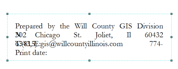

Code:
txtBlock = [
'Prepared by the Will County GIS Division',
'302 N Chicago St. Joliet, Il 60432',
'T:(815) 774-6343, E:[email protected]',
'Print date: <dyn type=\"date\" format=\"\"/>'
newTxt = "\n".join(txtBlock)
# list the mxds of the workspace folder
for mxdname in arcpy.ListFiles("*.mxd"):
    print "checking document: {}".format(mxdname)
    mxd = arcpy.mapping.MapDocument(ws + "\\" + mxdname)
    for elm in arcpy.mapping.ListLayoutElements(mxd, "TEXT_ELEMENT"):
        if " DATE" in elm.text.upper():
            print str(elm.text) + "\n"
            print "++++++++++++++below is repr+++++++++++++++++++++"
            elm.text = newTxt
            print repr(elm.text)
Print out:
Print Date: 11.2.2018
302 N. Chicago St. Joliet, Il 60432
u'Prepared by the Will County GIS Division\n302 N Chicago St. Joliet, Il 60432\nT:(815) 774-6343, E:[email protected]\nPrint date: <dyn type="date" format=""/>'

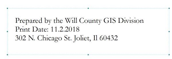

In the map, the text box still goes from this:
to this:
