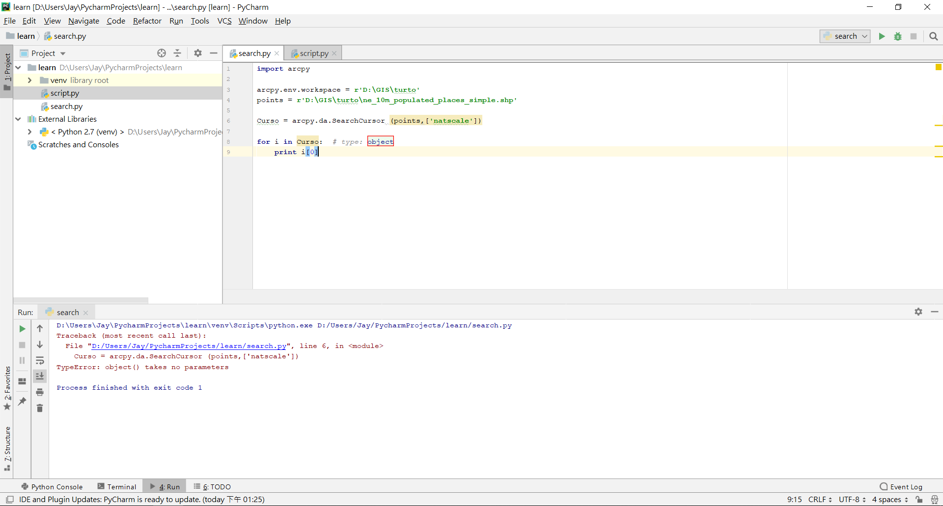

Hi I'm just learning the function of SearchCursor
this is my code here
import arcpy
points = r'D:\GIS\turto\pop.shp'
with arcpy.da.SearchCursor(points,['iso_a2', 'adm0_a3']) as citycursor:
    for x in citycursor:
        print(x[0]);
and the error just show:
D:\Users\Jay\PycharmProjects\learn\venv\Scripts\python.exe D:/Users/Jay/PycharmProjects/learn/search.py
 File "D:/Users/Jay/PycharmProjects/learn/search.py", line 10, in <module>
TypeError: object() takes no parameters
Process finished with exit code 1
I followed the tutorial of this one
6 - Search Cursors - Arcgis Scrpting with Python - YouTube
and I checked the syntax and other examples, all didnt help
the sitauation
I wonder what I do wrong
Please help me, thank you

Hi, I can use other arcpy funtions such as search by location, so it means the arcpy in pycharm is imported correctly, right?
I'm using the python 2.7 which came with ArcGIS 10.5
I was wondering what was missing

yes, I just downloaded from the Nature Earth website for the tutorial. And as Mitch tested, the data is fine.
