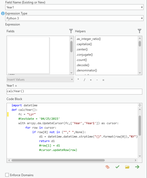

But the field "Year1" doesn't get populated/updated.

Spaced that you are doing this in a field calculator. You don't use a cursor in a field calculator because it will iterate over all features for each feature. Field Calculator has its own iterator so you do not have to set it.
Create the calculator on the target date field. Pass in the string field and return the value.
calcYear(!Year!)
import datetime
def calcYear(strYear):
    return datetime.datetime.strptime(strYear, '%Y')
