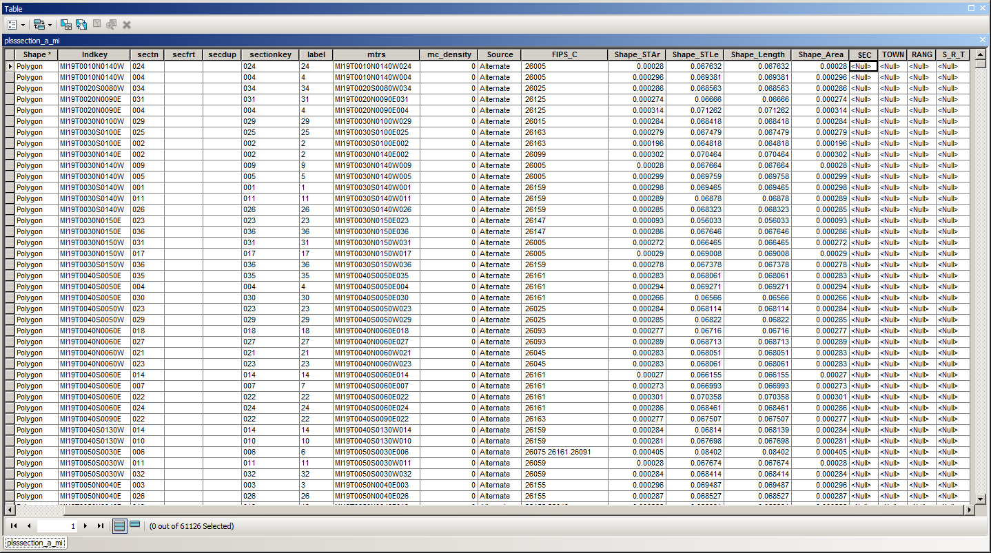

I have the following attribute table. I need to update the fields using the field calculator (SEC, TOWN, RANG) by using the "mtrs" and "label" columns(fields) in the attribute table.
SEC: (letter S + label)   TOWN: (string from mtrs)    RANGE (string from mtrs)      S_R_T (join the SEC+TOWN+RANG)
S24                               T1N                                     R14W                                      S24-T1N-R14W
S4                                 T1N                                     R14W                                      S24-T1N-R14W
S34                               T2S                                     R8W                                        S34-T2S-R8W
Can somebody help me to achieve this using the "Field Calculator" and Python parser functions?
