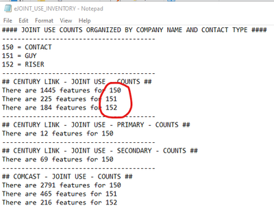

The issue I am having is when this exports the File GDB Table to a .TXT value, the domain code is exported. I need to have the domain description when the data is exported to the .TXT file. I have verified that the domain is assigned to the specific field.

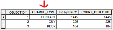

This is the python script the creates the statistics and write it to a File GDB Table. I verify the domain is added to the field within ArcCatalog. The field with the domain added is CHARGE_TYPE. When the data is printed to the Python Idle screen AND/OR the .TXT file, the code for the domain is displayed instead of the domain description.
ArcCatalog: CHARGE_TYPE field showing the Domain Description
.TXT exported file showing the domain code. What is circled in red, the goal is to have the domain description instead.
