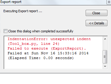

Error message:
Someone have an idea what can be the the reason for this error?

                    2) select data frame   This line should be
#                    2) select data frame
you forgot to comment it out

I see you edited the original question to account for the missing comment as suggested...does this mean you are still getting the same error?
אילןעזריה
Hi,
The tool is working now.
Thank you.
