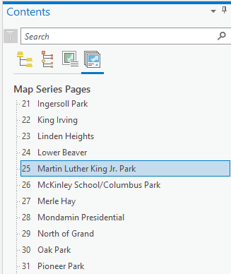

The script now exports each page but it stops at page 25
Do you have any idea why it's doing that?
