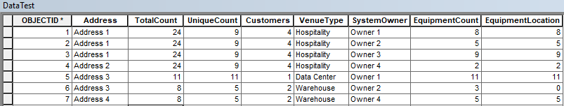

Currently I'm using SUMIFs in Excel to calculate some values in a spreadsheet and then having to make the updates manually in my attribute tables or reloading all of my data into the feature class. Is there a way to do SUMIFs using Python in ArcMap? One method I came up with was using Summary Statistics. For my current workflow, I'd need to do it three different times and then either join the tables or use cursors to populate the information.
I need to get the sum of a field based on the address for another field's values. Another calculation is a max value based on address for another field, and then lastly need a count for an address for another field.
My original thought process was to create a basic python tool using arcpy.Statistics_analysis (Summary Statistics) where my sum fields would be [[EquipmentCount, SUM], [EquipmentLocation, MAX], [Address, COUNT]] and my case field would be Address. The output would ideally be In Memory where I can use search cursor to build a dictionary where Address is my Key and the rest of the values would be the values. Using Update Cursor, I would populate the TotalCount field (using value of EquipmentCount - SUM), UniqueCount field (using EquipmentLocation - MAX), and Cutomers field (using Address - COUNT).
However I am trying to find another way to do this without having to go down the summary statistics route. I was hoping to use Field Calculator if possible or another alternative. I do not have any experience using the Pro-Logic in Field Calculators or numpy for that matter.

VishalShah2
Hi Joshua, I've updated my post with a screenshot of the table I have for testing.

VishalShah2
Hi Dan, I've updated my post with a view of my table that I am using for testing with some further steps as to what I had in mind. My current method I can script out using python but I was hoping to find a faster method if possible.
