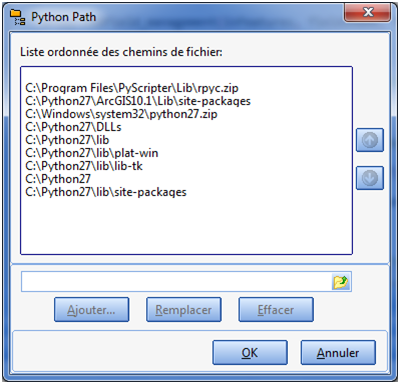

Hi dan,
These are the python path illustrated with Pyscripter
DanPatterson_Retired
MVP Emeritus
did you also verify stuff in the link Rebecca sent you?  You have to check other things as well.  Read carefully, it may help

ben_abdallahmhd
Deactivated User
hi rebecca,
thank for the link.
no the sccript run from pyscripter as external run.
No the problem is the Access to the clasa. The class exist but the message is the class "does not exist"
ben_abdallahmhd
Deactivated User
Hi rebecca,
I solved the problem of "no module named arcpy" by the link given by you and i run the script in pyscripter with external run.
The second "problem" of the class "does not exist" i solved it by re-writing the path of connection file in the script.
Final thank you very much for your help
