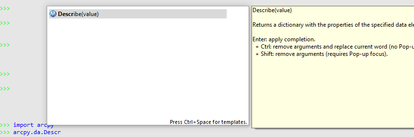

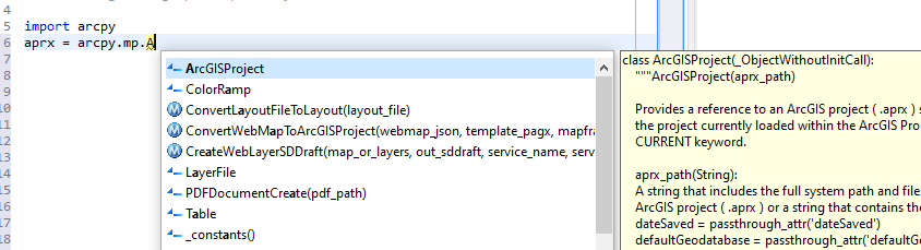

I am coding in a Python IDE (integrated development environment), not in Pro. When I do import arcpy, I can then work with most everything I need.  For example, as I write my code, I get code hints telling me about objects, functions, and properties, as you can see in this screenshot: dcafdg_0-1642029951174.pngdcafdg_0-1642029951174.png
Now, if I try to work with anything in the arcpy.da package, I don't get code hints, and also get errors in the IDE's editor. Hovering my mouse over the error, it says "Undefined variable from import: Describe".

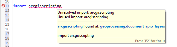

davedoesgis
That has the same result. I think that's the problem is the whole arcgisscripting package loads from a DLL (as a .pyd file) at runtime and not as source code. The import produces an error in my IDE, but will execute.
My IDE can add DLL and PYD files to my PythonPath, but I have to locate it in order to do so. I have traced through the Esri source code about as far as I'm able to. It ends up calling function convertArcObjectToPythonObject in C:\Program Files\ArcGIS\Pro\Resources\ArcPy\arcobjects\arcobjectsconversion.py and that's where I lose the trail.
