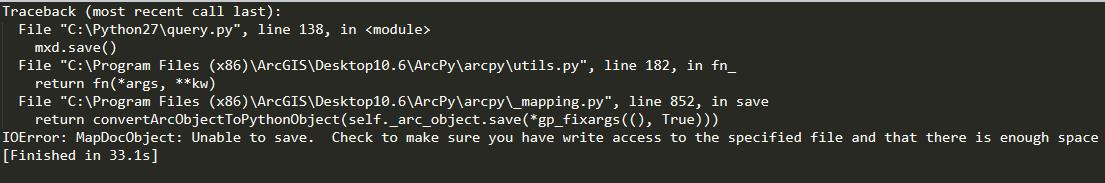

RickHawkins
i added mxd.save() and got the following:
I pretty sure  that i have access to the file.
Javier_AntonioEscudero
According to Joe Borgione mentioned, Use "r" before a variable that include a path,
Use
mxd = arcpy.mapping.MapDocument(r"C:/GISMAPS/LUS Map.mxd")
instead of
mxd = arcpy.mapping.MapDocument("C:/GISMAPS/LUS Map.mxd")

RickHawkins
I added the new path and still got the same answer
Try executing the Python Script as administrator to test if is a permissions issue.
RickHawkins
ran as admin and still received the error. I am sorry for taking up so much of your time. I do appreciate it
Adds the mxd.save() command before quit the full program , may be in  line 115, inside commit function. Don't forget indentation.
