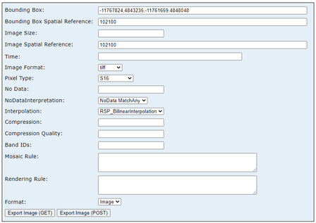

Here is what this looks like using the HTML interface. Clicking "Export Image (GET)" initiates a download of the raster as a .tif file, exactly as I need.
I would like to be able to do this using Python/ArcPy exclusively (updating the parameters as needed), as part of a larger script. I have had a shockingly difficult time Googling this or finding any resources about how to do this, so I'm missing some very basic concepts here.

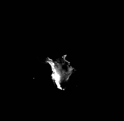

 gives me this:

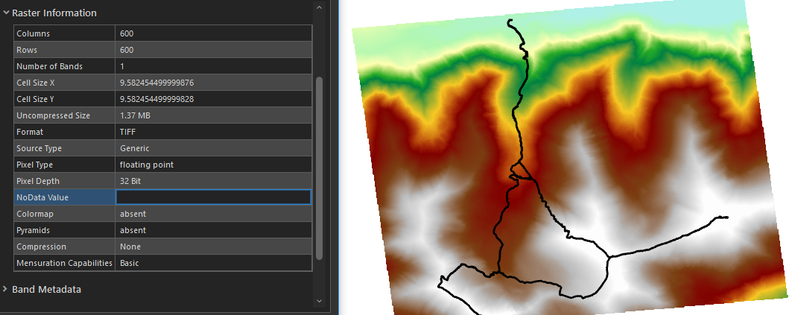

The question I have is about specifying pixel size, which oddly enough does not seem to be an option based on the documentation here:
https://developers.arcgis.com/rest/services-reference/enterprise/export-image.htm
Below my pixels are roughly 10x10 (meters) because I've specified a size of 600,600.
