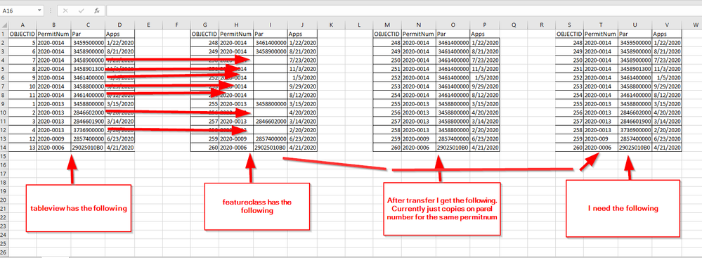

Base on the PermitNum, For example permit 2020-0014 has 7 records in the Par field in the table I need it to transfer the tables Par field records to the feature classes Par field if they don't exits in the feature class, 2020-0013 has 4 permit records in the table I need to only transfer  the two Par records to the feature class since it already the feature class already has two populated. I don't need to transfer ones that already in the feature classes Par field. Hopefully this makes sense.  I can attach some data if that would help?
Thank you for responding I am very appreciative.
DonMorrison1
If you are sure your table and feature classes line up (after being sorted) as you show in your diagram then you should use a list to store your table data instead of a dict. This will preserve the order so you can step through one rows at a time and move the Par field over when you find an open slot.  But I'd be surprised if your table and feature class really are lined up like that......

Unfortunately they are not lined up like on the pictured I attached, I was trying to give an example. I have attached some sample data if anyone is kind enough to help me out as I am not sure how else to accomplish what I need.
DonMorrison1
For this to work you must have a field or combination of fields in your table view that uniquely identifies each record in that view AND the "matching record" in the feature class. I may be wrong but it appears to me that you don't have this so the problem really has nothing to do with python but in your data.

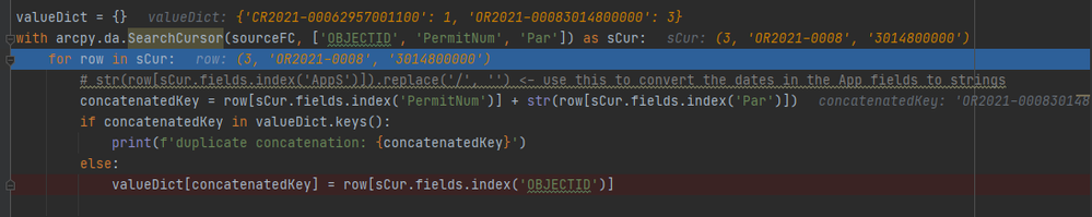

This is an image of the code at work so you can see the values in the dictionary:
valueDict = {}
with arcpy.da.SearchCursor(sourceFC, ['OBJECTID', 'PermitNum', 'Par']) as sCur:
    for row in sCur:
        # str(row[sCur.fields.index('AppS')]).replace('/', '') <- use this to convert the dates in the App fields to strings
        concatenatedKey = row[sCur.fields.index('PermitNum')] + str(row[sCur.fields.index('Par')])
        if concatenatedKey in valueDict.keys():
            print(f'duplicate concatenation: {concatenatedKey}')
        else:
            valueDict[concatenatedKey] = row[sCur.fields.index('OBJECTID')]
Then once the 'source' dictionary is built, you concatenate the same fields in the target shapefile and use it to lookup the valuesDict.
