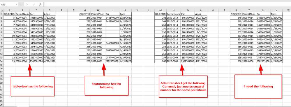

I have the following script and the issues I am having is that the PermitNum can have multiple Par (par field) numbers but my current script will only populate the Parel field with just one Par attribute, it doesn't transfer each parcel that corresponds with each permit number. How can I adjust my current code to transfer each parcel number?

Just curious - in your "I need the following" graphic, how do you know which values to put in the 'Par' column? Since 'PermitNum' is not unique you must be using some other piece of information (I assumed it was the date field but it appears that is wrong).
CCWeedcontrol
PermitNum should be the unique identifier but as you can see PermitNum has duplicates because I don't have no other Unique Identifier.

The dict is exactly what I would expect. But, I still don't understand your objective - and will ask this again:
