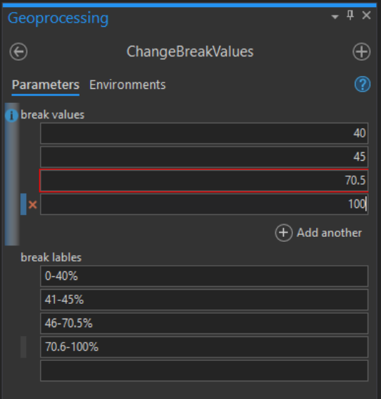

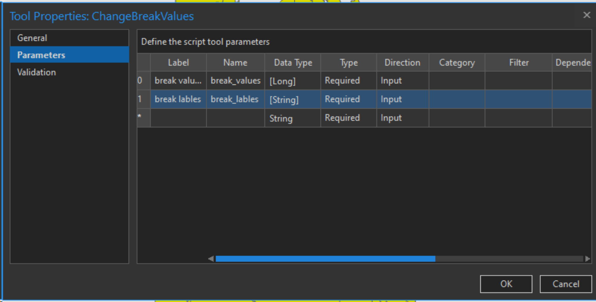

I have a script tool that sets a layer's break values and their labels. The user will also need to enter decimals as values. I can't seem to get the tool to do that. Here I have the break values set to accept a Long data type. I've also tried a double, and a string.
The break values entered into the tool are forced to be integers in the script.
#class break values
classbreakvalues = sys.argv[1] #break value parameter entered here
breakvalues_list = classbreakvalues.split(";")
new_breakvalues_list = []
for brkvalues in breakvalues_list:
    newbreak = int(brkvalues) # integer value
    new_breakvalues_list.append(newbreak)
classBreakValues = new_breakvalues_list
If I run the following, the tool won't accept a decimal value.
I get this error, which I understand to mean you can't have an string as an integer. But I don't see how that could be.
ValueError: invalid literal for int() with base 10: '70.5'

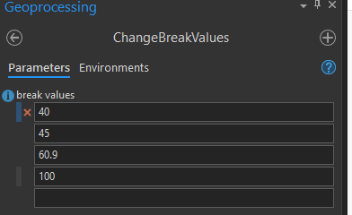

All three of the following arrangements in the code are successful when running them from the script tool. But, not one of them change the break value to a decimal in the layer's symbology. This leads me to believe something is up with the tool.
#Results in neither decimal in layer symbology nor print statement
    newbreak = int(float(brkvalues))
    arcpy.AddMessage(f'newbreak: {newbreak}')
#prints these values
#break value: 40
#break value: 45
#break value: 60
#break value: 100
#No decimal in layer symbology, but decimal in print statement
    newbreak = float(brkvalues)
    arcpy.AddMessage(f'break value: {newbreak}')
#break value: 40
#break value: 45
#break value: 60.9
#break value: 100
from decimal import Decimal
    newbreak = Decimal(brkvalues)
#break value: 40
#break value: 45
#break value: 60.9
#break value: 100
