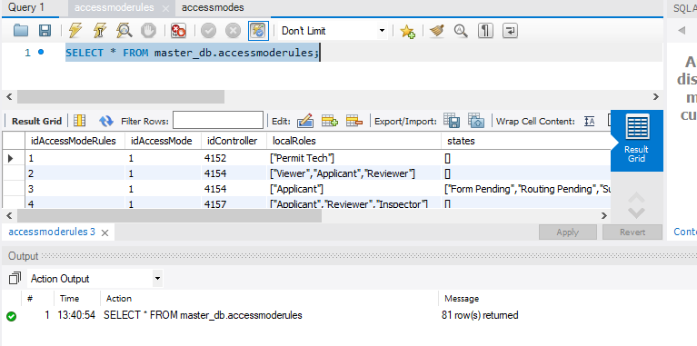

I can run that very query in a MySql Workbench window and get what I want:
What am I missing on the python side of things?
