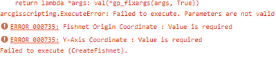

The size is ok because it is always 2m. It is using the template (another layer) set as a parameter that is the issue when its scripted in python.  I get the following error.

It looks like you have to get the origin from the template featureclass then
