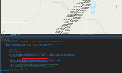

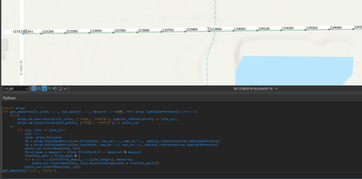

There is actually still some floating point error in the values! It seems to happen when a line feature is traveling at an oblique angle to the planar system's grid:
I was able to reduce it down quite a bit by pulling the value directly from the _arc_object of the Point instead of letting arcpy convert it to a double first. Also used the builtin Decimal class for more strictly accurate decimal operations. It would be nice if arcpy would use Decimal by default so there isn't precision loss during the conversion to a float/double.
