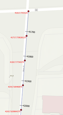

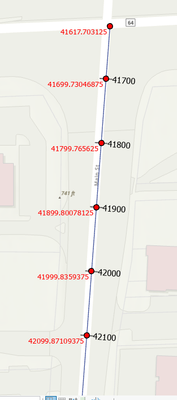

@HaydenWelch, thanks for the reply. Unfortunately, neither code block was the solution to my problem; I also tried your comment from the addendum and this also was not the solution. Below are two screenshots that show the results of the suggestions you provided.
The first screenshot shows the results of the code block without the addendum suggestion (both the longer one and the simplified one). The second screenshot is with the added addendum suggestion. The red labeling in both screenshots is the "Measure" or M value's as derived from the line for each point while the black labeling M values needed. Basically the points need to be exactly in the location of the lines labeled station points/tick marks.
As you can see from the first screenshot, just the code block as is (no addendum / modulo), the created points do not fall at the correct interval and are instead at 100 ft intervals starting from the 1st point. The second shot shows that the included addendum gets closer to the solution, but still does not get the exact measures/locations needed (see red labeling vs. black labeling).
From my own testing and python hacking, I originally came to the same conclusion as you regarding the use of the modulo (line.firstPoint.M % measure), but ultimately the results of my own python code block were about the same as the second screenshot. What I was finding though was after returning the first point after the starting point that has an M value divisible by 100 (use the modulo method), the value needed to measure along line (use positionAlongLine function; line 12 and 13) did NOT find a point at the location on the line where the stationing / M value was a value divisible by 100 even though the "dist_to_meas" value + firstPoint.M == M value divisible by 100 (EX: 41700). I'm not sure if its a geometry thing or spatial reference/coordinate system thing, but I couldn't figure out the correct method to find the "dist_to_meas" value to use in the positionAlongLine function that would return a point at the exact station / M value needed.

I'm not sure that's necessarily the issue though. I believe the issue I am running into is due to the fact the first point's M value is a float value and not an int (whole) number; the first point's M value in the polyline is 41617.703125. The next nearest M value along the line divisible by 100 should be found using the following method:
  • 100 - (first point M value % 100) --> 100 - (41617.703125 % 100) --> 82.296875 --> lineFeature.positionAlongLine(82.296875) --> should return point at M value 41700.00 (but doesn't).
Is there a level of imprecision that this geometry function has baked in? Are their differences between what an M value is and what is returned by positionAlongLine function (i.e. can't use the return of the modulo as its calculated based on M value as the "measure" distance value in the function)?

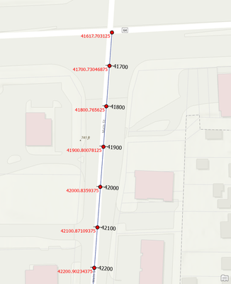

Using your suggestion of casting the return from the modulo line from float int did not resolve the issue. The updated function below:

The results:

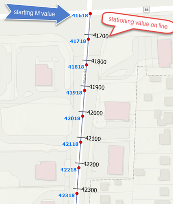

Yes, I checked both the coordinate systems and they are the same. I also tested the geodesic parameter and that also did not resolve the issue (it didn't seem to affect the result in any meaningful way; not sure if it's a scale thing).
I'm also not sure if it's a precision thing between what is stored in the geodatabase and what is being read by python. When attempting alter a point's M value from 41617.703125 to 41618.0 using the regular GP tools, the M value will read the appropriate whole number, but when querying the point via arcpy, it will return a floating point number (e.g. 41617.99328513).
In any case, I was able to build a workaround for this issue by creating an Event Table, populating it with the routes and M values needed, and then using the GP tool "Make Route Event Layer". This created the necessary points along each route at the intended locations. My unfamiliarity with the available linear referencing GP tools in ArcGIS Pro caused me to not read into it deeply enough.

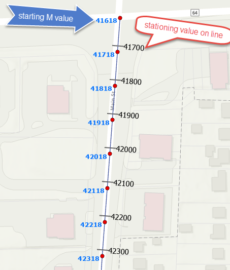

KevinPiraino2
Hayden,
Nope, both map and data are in the exact same coordinate system (NAD 1983 StatePlane Illinois East FIPS 1201 (US Feet); WKID 3435). Everything related to this project was in the same coordinate system. Again, I'm not entirely sure what the issue is, it appears on the surface to be how the Desktop GUI software is interpreting certain values vs. what is either stored in GDB and accessed by python or how the python interface is interpreting the data.
Basically the Desktop GUI will read and write the whole number 41618.00, but the python interface interprets that as 41617.99235 either because that's what is stored in the GDB / geometry or something else entirely.
