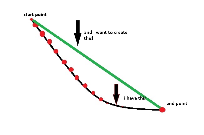

1). Hello i want to create 2 species of line. The first i created it with straight segment form editing tools, as for the second i want it to have the same start and end point but to be drawn as a chord on the terrain, and not on the surface of it, to calculate the difference of their heights.Any help? Should i use traverse editing tool for that?

Can you explain what exactly it is you mean by "chord"? If you have a picture to explain what you are after that would be helpful too.
KONPETROV
i want to create the green line which will be precisly above the black line, because i want to calculate the differences at their altitudes at the points with red colour
