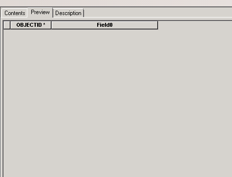

I have a script which writes the lat/lng of a json web service of bus routes.  The script writes the latitude and longitude to a CSV correctly.  However my table to table conversion does not work correctly in Python.

     This is my table output when running in Python.
         This is the output, when using ArcToolBox in ArcCatalog.

I would probably create the output table first, add the fields and use an insert cursor to fill the table:
import os
fgdb = r"C:\dev_folder\orginalDev.gdb"
tbl_name = "jsoncsv2"
tbl = os.path.join(fgdb, tbl_name)
fld_lat = "Latitude"
fld_lon = "Longitude"
arcpy.CreateTable_management(fgdb, tbl_name)
arcpy.AddField_management(tbl, fld_lon, "DOUBLE")
arcpy.AddField_management(tbl, fld_lat, "DOUBLE")
flds = (fld_lon, fld_lat)
with arcpy.da.InsertCursor(tbl, flds) as curs:
    for items in parsed_json['items']:
        row = (float(items['longitude']), float(items['latitude']), )
        curs.insertRow(row)
MahtabAlam1
ArcMap/ArcCatalog will automatically create a schema.ini. Please look Adding an ASCII or text file table
In absence of schema.ini arcpy.TableToTable_conversion tool might give unexpected results especially when are executing a standalon python script. You can provide the field_mapping parameter or consider creating your own schema.ini file.
