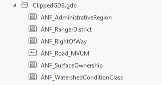

The path for ClippedGDB.gdb is:
r"C:\GIS6340\Final_Project_GIS6340\FC_03132022\ClippedFC\ClippedGDB.gdb"

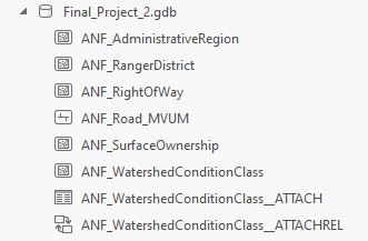

The path for Final_Project is:
r"C:\GISData\Final_Project_2\Final_Project_2.gdb"

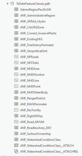

The path for MainGDB:
r"C:\GIS6340\Geospatial_Library\ToDateFeatureClasses.gdb"

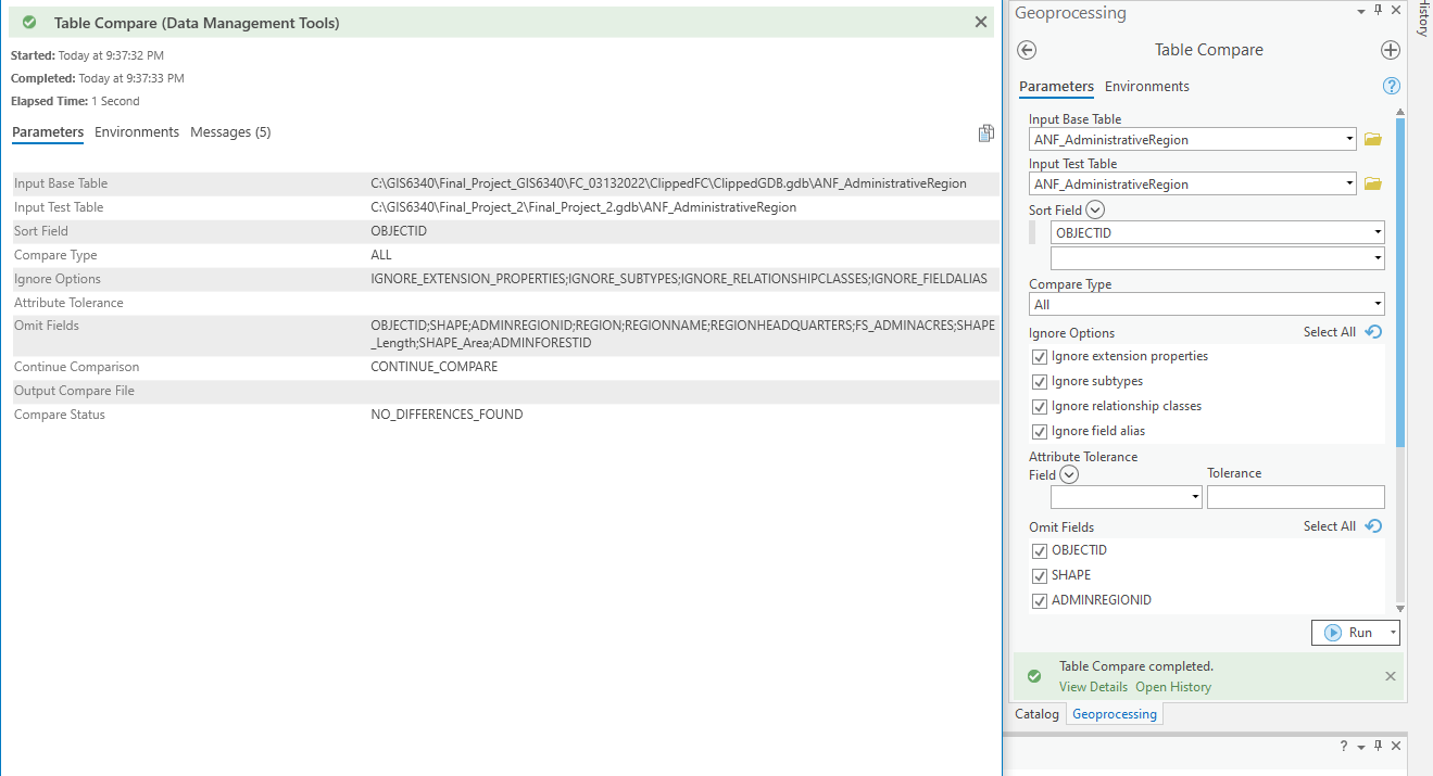

Per the table compare tool, the in_base_table is the correct data, which in this case its the Clipped GDB feature classes, and the in_test_table is the ProjectGDB feature classes.

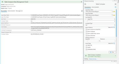

I can run it individually through Pro:
which is correct. What I am trying to do is create a script that iterates through each feature class from each geodatabase and print out the name if there are changes.

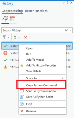

You could call the same Table Compare tool from python code.
After you run Table Compare geoprocessing tool from ArcGIS Pro click Open history. Right click on Table Compare item and choose "Copy Python Command" and paste it to your code. Change input parameters depending on your code.
