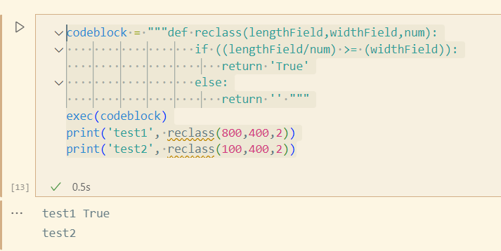

AHhhh, now that makes sense. Either "True" or "" goes into the attribute as its new value. Okay.
Passing Python code uninterpreted into a function like that creeps me out. 🙂 But that's me. I bet you can pass the strings to "exec" to test. After all, Esri must be doing something like that.
Yes so you can do this, but it runs fine, no errors.
