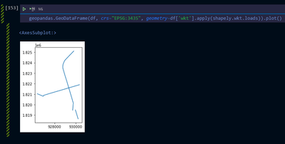

jblng
Hello @jcarlson, I'm trying to do the same thing as OP. Do you have any tips on successfully creating an environment where arcpy and geopandas work together? I am using a cloned python environment in ArcGIS Pro. I am getting a failed message when trying to conda-forge install geopandas. I also am worried about the same thing occurring when trying to install shapely.. Many thanks!
jcarlson
MVP Alum
I do occasionally run into issues when geopandas and arcgis are used together; it seems to be related on where my scripts are run from. I use Anaconda to manage my python envs, and run my notebooks from there, or else through the (recently updated and much improved) notebook viewer in VS Code.
As a general rule, I don't really mess with python envs in Pro. Times I've attempted to clone and modify the Pro python env, I've had nothing but trouble. If I need arcpy, I just stick to what's available via arcpy and the default env.
You'll notice in my post that I don't actually use arcpy at all, just arcgis and geopandas.
