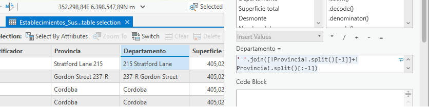

Hello @EGardner7 for your last question you can try this code, works fine for your examples. This code move the last part of your address to the front of your address. Move always the last part regardless of whether they are numbers or letters.
' '.join([!YourAddressField!.split()[-1]]+!YourAddressField!.split()[:-1])
- Regards!, Esteban Marcelloni
Image 1: I convert Provincia to Departamento
