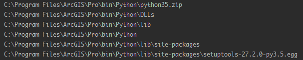

I'm starting the process of moving some of my 2.7.x scripts to 3.5.x for use with ArcGIS Pro.  I have configured PyCharm to use the python interpreter packaged with ArcGIS Pro 1.4.1, located at the following: C:\Program Files\ArcGIS\Pro\bin\Python.
However, arcpy is not recognized as an available module.

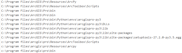

If I run sys.path from within PyCharm, I get the following paths:
If I run sys.path from within ArcGIS Pro, I get the following paths:
What do I need to do in order to get PyCharm to be able to use arcpy?  Do I need to add system environmental variable paths?  If so, from the list returned in ArcGIS Pro, how many need to be added?

There is a python.exe within the %Pro%\bin\Python\envs\arcgispro-py3 folder which should work if set as a project interpreter in PyCharm.

I was able to add in content source folders for my project, and when running sys.path, it returns the folders that are shown within ArcGIS Pro (screenshot below), but I am still getting an error that a module can't be found.
sys.path
error message with importing arcpy
mpboyle
Honored Contributor
Thank you so much, this works!
