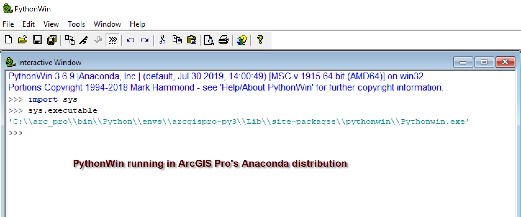

import sys
sys.executable
what does that report? and is it to the python that arcmp uses?

when i enter the two commands into a pythonwin window i get nothing showing in the results section

o you don't see something like this ?? (I can run pythonwin form ArcGIS pro, so the first part of the path isn't relevant... only the portion from … site-packages onwards is key
If memory serves, python for arcmap is installed in c:\python(version number etc)

i get the following:  'C:\\Python27\\Lib\\site-packages\\pythonwin\\Pythonwin.exe'
