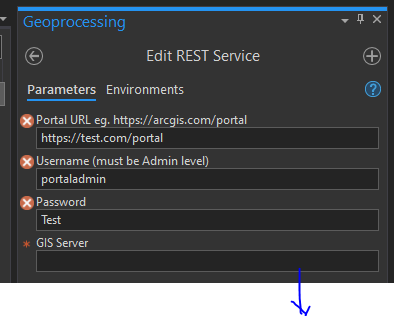

@Anonymous User I'm attempting a python toolbox for the first time and hitting a wall. I would like the enter the Portal URL, username, password and have the GIS Server parameter auto populate with a drop down list of all my federated servers. If I comment out the updateParameters method, then I can enter the other parameters without the error. Any ideas what I need to do here?

Couple of things here that I would try- I think you need to set the param0-param3 to be instance variables by adding the 'self.' in front of them.  Class variables (without the self.) can only be assigned when a class has been defined. Instance variables (self.) , on the other hand, can be assigned or changed at any time.  Then you can access them/change them in your other class methods by also referring to them with the 'self.' prefix. You also need to get the values of the parameters, instead of passing the complete param object so adding .valueAsText() on the end of them should get you the string value.
tigerwoulds
Thanks! After some tinkering, I've got it working. I can enter my portal url, user, password and I get a list of GIS Servers to choose for the 3rd parameter.
