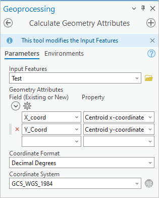

I would try Calculate Geometry Attributes, setting a coordinate system to DD.
https://pro.arcgis.com/en/pro-app/3.0/tool-reference/data-management/calculate-geometry-attributes.h...

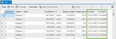

You can specify two new fields, specify the coordinate system, and the DD coordinate output format.
You will get your polygon feature class with the centroid fields added with the DD values.
 In Python:
arcpy.management.CalculateGeometryAttributes(
in_features="Test",
geometry_property="X_coord CENTROID_X;Y_Coord CENTROID_Y",
length_unit="",
area_unit="",
coordinate_system='GEOGCS["GCS_WGS_1984",DATUM["D_WGS_1984",SPHEROID["WGS_1984",6378137.0,298.257223563]],PRIMEM["Greenwich",0.0],UNIT["Degree",0.0174532925199433]]',
coordinate_format="DD"

I have tried this tool and working as expected. I need to update centroids of a polygon in  latitude and longitude automatically whenever we create a new feature/ split/ merge features. it should behave like a trigger in SQL.
