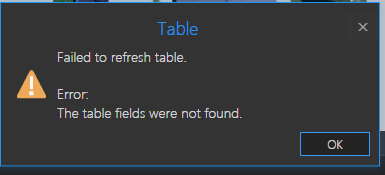

I'm writing four tools to calculate X and Y coordinates in Northing/Easting then create a spatial ID based off of those coordinates. Each one will be stormpoint, stormline, sewerpoint, sewerline. So far, everything works exactly as planned except the part where CalculateGeometryAttributes_management deletes any layer that it doesn't work on. So if I have 5 stormwater point feature classes and input two it will delete the other three entirely. And just as a sanity check, I made sure that no other part of this code deletes entire feature classes when the tool runs. It produces this error since it can  no longer find any data in the tables:

Update: Progress is slow but I have figured out the reason for this issue. arcpy.CalculateGeometryAttributes_management does not play well with multivalue inputs. No matter what I do it will not accept any parameters with multiValue=True. For now, I created a separate tool and removed multivalue functionality. That leads me to an entirely other issue... I have a dozen layers I want to programmatically attribute.
