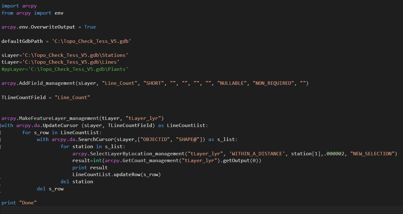

I am trying to create and update a field with a count of line features (tLayer) within a distance of point features (sLayer). I am attempting to use a combination of AddField_management, arcpy.da.SearchCursor, SelectLayerByLocation_management, arcpy.GetCount_management, and arcpy.da.UpdateCursor. The code I have for this is currently updating all records for the Line_Count field with the count of the point features (i.e. 2) for only the (second?) record. Though, a print statement following the GetCount line will return the line count for all of the point features (with a few unessential iterations).
What do I need to do to appropriately update the Line_Count field for all of the records? Also, this process will be applied to a large dataset and will be extended to include 'where clauses'; are there any suggestions as to how to make this as efficient as possible. Any tips or suggestions would be helpful.
Thanks in advance!
Tess
Updated Line_count Field (inaccurately recording a count of '2' for each record) :
actual line count values for records as returned by print statement:

some severe indentation problems after the...  for station in s_list: ... I thought it was just the code pasted above but it also exists in your image.  A lot of people are having issues lately with mixing cursors as well... you might want to check those out in the python place

Well, here we have another embedded update with a search cursor on the same feature.
I don't think this is the correct approach. First read the data into a dictionary (as per other posts rfairhur24)
Then do the updates.
You are also deleting s_row within the inner loop, so what will the inner loop do with the updateRow without this object?

Thanks, I missed that one too. The formatting ended up getting pretty messed up btw Notepad ++ and Visual Studio and I was terrible about fixing it. I do have a lot of work to do as far as understanding loops and multiple cursors (and probably everything else). I'll check out Richard's posts. Thanks!

So I think it is only printing the last row in 'result' for the Line_Count update statement. Is there an efficient way for result (i.e. result=int(arcpy.GetCount_management("tLayer_lyr").getOutput(0)) ) to be saved as a list or an array that can be written to the Line_Count field?

A post in GIS Stack Exchange provided a solution for this as well as some additional useful comments. Though, as this script will be applied to large data sets where efficiency will be a necessity, I will need to look into wrapping in more geoprocessing tools (i.e. near table, frequency table, and others) into this process.

I'm just going to reiterate what Neil said and recommend you check Richard's blog post about cursors and dictionaries(though he accidently tagged Richard and his page instead of that particular blog post).
