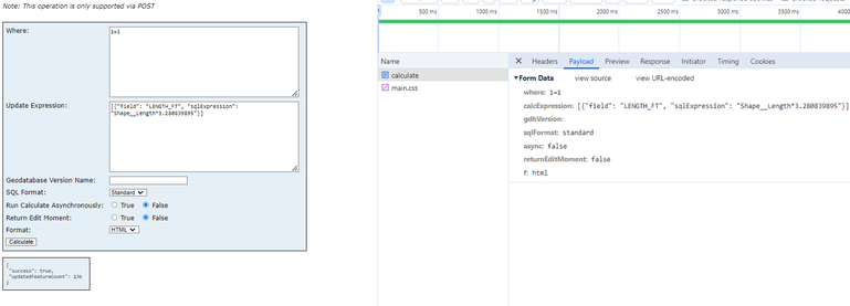

kapalczynski
got it... hunting and hunting finally looking at the network payload in the browser i saw the parameter was called calcExpression not expression or Update Expresstion in the image above... ... gotta love cryptic naming conventions ESRI puts out... parameter names are different for each method of updating... uggg
    url = urlCalculateFeatures
    whereclause='1=1'
    gis_payload = {
        'token': currenttoken,
        'f': 'json',
        'calcExpression':'[{"field": "LENGTH_FT", "sqlExpression": "Shape__Length*300.280839895"}]',
        'sqlFormat':'standard',
        'where': f'''{whereclause}'''
    print(gis_payload)
    response = requests.request("POST", url=urlCalculateFeatures, data=gis_payload)

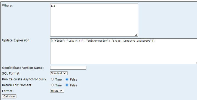

The above now works BUT I want to get this working against a REST service ...
So something like the below but not DELETE rather CACULATE
Any thoughts?
    url = urlDeleteFeatures
    whereclause='1=1'
    gis_payload = {
        'f': 'json',
    response = requests.request("POST", url=url, data=gis_payload)
    print("Done Deleting")
I am not sure how the expression would look

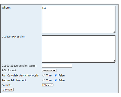

kapalczynski
Got with this:
BUT not sure how to get that into a python script..
Tried this... no error but nothing happening..
    whereclause='1=1'
    gis_payload = {
        'f': 'json',
        'url':'https://xxxx.xxx.xx.gov/env/rest/services/DEV/UpdateLengthField/FeatureServer/0',
        'expression':'[{"field": "LENGTH_FT", "sqlExpression": "Shape__Length*30.280839895"}]',
kapalczynski
    whereclause='1=1'
    gis_payload = {
        'f': 'json',
    print(gis_payload)
