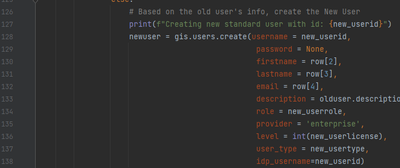

Take  a look at the following scripts here.  The scripts won't accomplish exactly what you're looking to do, but should provide some guidance.  For example, here is the portion of code that creates the Enterprise account by reading information from a CSV file:

Thank you Jake. This is really helpful. It seems like this whole process is a lot easier with SAML enabled
