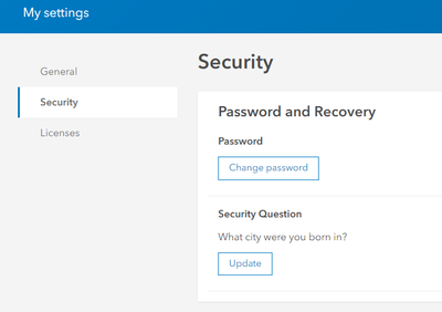

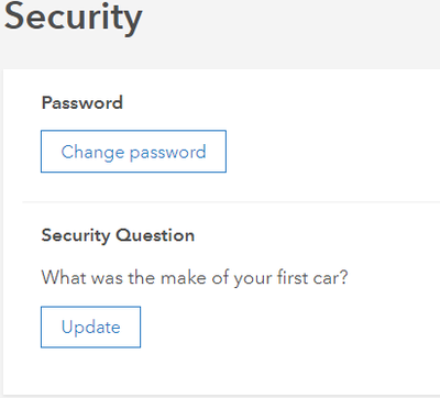

@ErikNelson1 do you have a security question set for the built-in account you are using?
ErikNelson1
@JakeSkinner yes, we do have a security question set for the built-in account we're using

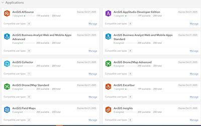

@TarigAhmedTXHSDS,
This column should be populated if you have any Application licenses (i.e. ArcGIS Pro, Insights, Field Maps, etc) assigned to the user.  Ex:
