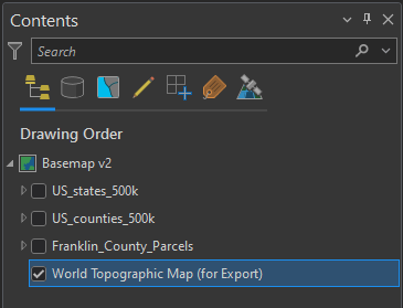

cweirpatrickco
Hey @JakeSkinner, the only basemap layer I have in my TOC is "World Topographic Map (for Export)"... which is the layer I'm wanting to export to .vtpk.
