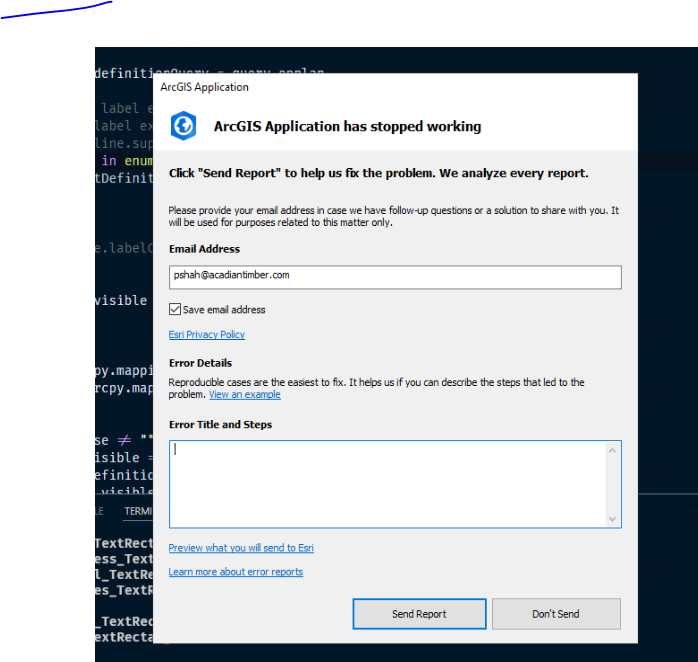

We are on the verge of migrating from the arcpy.mapping module to the arcpy.mp module. According to the documentation, it seems that label functionality has been changed to the LabelClass object. I can confirm that my layer supports label expressions, as shown by the command lyr.supports("SHOWLABELS"). However, when the code reaches the part where a setDefinition is implemented, I get an error message.
"ArcGIS Pro caused an error and it causes script to break".

Error message is ArcGIS Application has stopped working. even though Arcgis Pro is not open. And I have also figured out that the issue lies in when the set definition comes into place.
Thank you everyone in advance.

It's not possible to answer this question as you do not show what you do at the line "performing add join". I'm guessing that what ever you are doing there is creating a corrupted definition object which is the input to lblClass.setDefinition() and causes the script to catastrophically fail. I believe a limitation of accessing CIM is that there is no validation of the parameter, unlike tools you call in arcpy. So if you are not super careful in how you alter the definition object then you feed into CIM something that syntactically invalid and having by-passed any sort of validation you kill the script/application.
