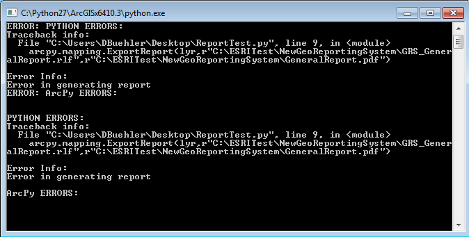

The goal is run a report via python script periodically via a scheduled task. If there is a better method for scheduling I am all ears, but the crux of my issue is getting the python script to run outside of ArcMap.  It runs fine within ArcMap, but as a standalone script it throws errors.  Below is my code and an image of what errors it giving me.  Any help is much appreciated.

I found that very same link, and was reading it over.  That is the issue.  32-bit vs 64-bit. I solved it by just telling the task scheduler to fun the 32-bit version.

Actually it does help.  I was digging and digging and I found what both you and James are talking about.  It is a 32-bit vs 64-bit issue.  What I did to solve the problem was just tell the scheduled task to use the 32-bit version as the program to launch, and pointed it to the .py file.  It worked like a charm. Now if I can figure out how to make it use the 32-bit version from inside the script and do a few more things, I will be all set.  Thanks both of you for your help, and pointing me in the right direction.
