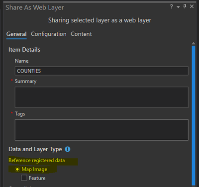

LeviCecil
It is registered with the server, and I've published this way. It publishes as a regular feature service, though. Not a referenced service.
