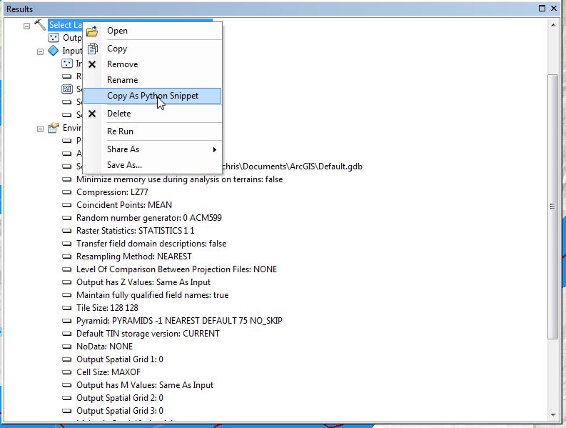

Even easier, one could also just run your process with the tool manually, then dump out a code snippet for that process after it was run manually by checking the Geoprocessing Results and capturing a Python Snippet.  The advantage of this is that the exact files used are already coded in as the inputs and outputs.  Here's an example that shows how to extract the Python Snippet used in a tool run:
