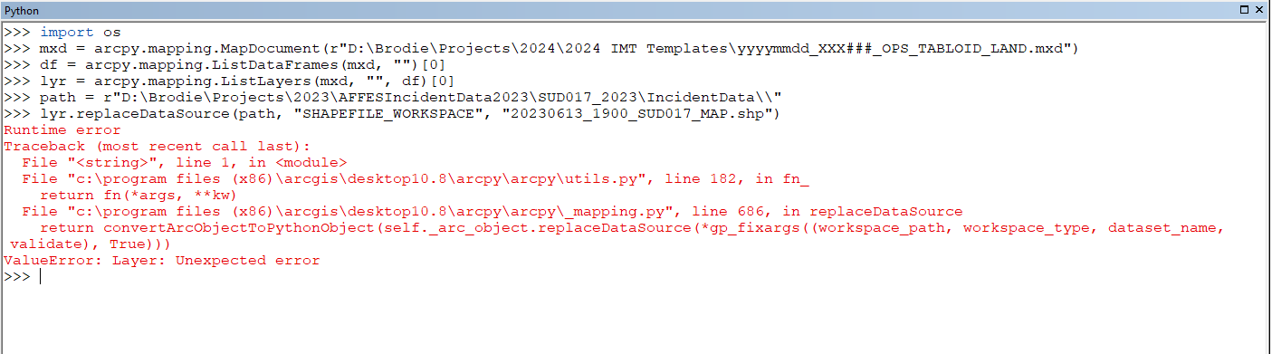

The original data source for the layer file is a shapefile and I am trying to update it to a new shapefile found in a workspace/ folder I have assigned the variable "path" to (see screenshot below).
The following screenshot is, from my understanding, a simple way to write the code. I was using the python window in ArcMap for troubleshooting purposes:
As you can see I receive an error message.
I have tried writing this script several different ways, even omitting the map document and pointing straight to the layer file (arcpy.mapping.Layer([path])) but continue to get this error message.
The mapdocument is added ("mxd"), as is the dataframe ("df"), and the layer ("lyr").

I haven't done this in ArcMap, but your path doesn't look right. Try removing the two trailing back slashes.

Thank you for your response - I tried removing the two back slashes but am receiving the same error.

Maybe use None for the wildcard parameter instead of an empty string.
df = arcpy.mapping.ListDataFrames(mxd, None)[0]
lyr = arcpy.mapping.ListLayers(mxd, None, df)[0]

Unfortunately, I tried using None for the wildcard parameter and received the same error message.

As far as I have seen, when working with a shapefile, the data source specified in the arcpy.layer.replaceDataSource function should not include the file extension.
I recommend removing the extension and trying again.
