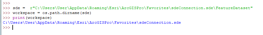

You say that os.path.dirname(sde) is reporting: "C:\Users\User\AppData\Roaming\Esri\ArcGISPro\Favorites\sdeConnection.sde".
Is that when you print(workspace), or just enter workspace at the prompt?  If this is the actual path being sent to the editor (just typing workspace at the prompt), then it will have issues.   The editor is expecting "C:\\Users\\User\\AppData\\Roaming\\Esri\\ArcGISPro\\Favorites\\sdeConnection.sde".
So, if the above code still doesn't work, I'd try hardcoding the workspace to see if it is related to that.

My testing had no issue with the raw string path if I set it directly in the arcpy.da.Editor(sde) instead of using workspace variable, but after the os.path.dirname(sde) it was having issues.
Not sure, I think it was returning the path as a string, not raw string so wasn't valid as input.
