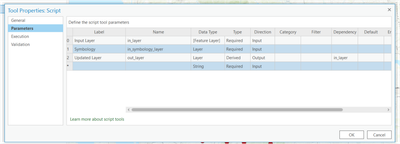

AvinashPatel
Check and apply the right parameters to update the layer symbology
import arcpy
import sys
def ScriptTool(param0, param1):
# Script execution code goes here
return
# This is used to execute code if the file was run but not imported
if __name__ == '__main__':
# Tool parameter accessed with GetParameter or GetParameterAsText
param0 = arcpy.GetParameterAsText(0)
param1 = arcpy.GetParameterAsText(1)
arcpy.management.ApplySymbologyFromLayer(param0, param1, None, "DEFAULT")
# Update derived parameter values using arcpy.SetParameter() or arcpy.SetParameterAsText()
