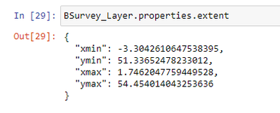

How can i add a spatial reference to a feature service?
my feature service is not showing  a spatial reference when querying the extent
but if i check another feature service it shows one

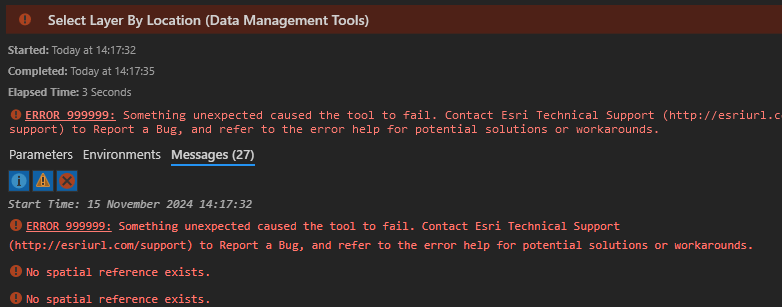

i think this is the cause of why my intersection or select by location in pro returns 0 results or just fails

StuartMoore
this for some reason the feature layers are all now showing with a wkid and select by location now works...
very odd
