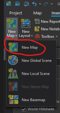

JaredPilbeam2
MVP Alum
Have you added a map to your Pro project or checked in the Catalog under 'Maps', if available? Last I knew when you bring in an *.mxd with arcpy it doesn't open a map automatically.
